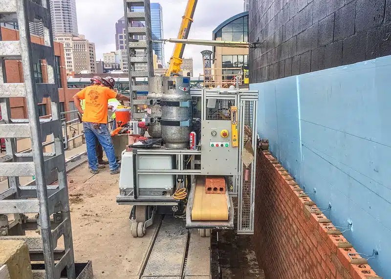

StrXur: So what’s the role of robotics in this?Podkaminer: It’s simple. We don’t see construction, especially on-site construction, ever being fully automated. There’s too much variance. Everything is dynamic and it’s not a controlled environment, so we’re beginning to see construction and automation equipment being leveraged by workers to make them more efficient. Workers will always be part of the equation. What SAM does is amplify the workforce: If you have two masons and a laborer working with SAM, instead of getting somewhere between 300 and 500 bricks a day per man, now your two masons can get anywhere between 2,000 and 3,000 bricks in eight hours. The masons can focus on quality, and SAM can take away the heavy lifting.

On top of that, if I were to show you a picture of two jobsites, one with a regular crew and one with a SAM crew, you’d see a stark difference. When you look at the one with the SAM crew you’ve got your cubes of brick, you’ve got your mortar bucket, and you’ve got three workers and a robot. Very clean. There’s no trash, no debris. And then you look at the other one and you’ve got about 25 guys. You’ve got brick everywhere. Mortar everywhere. Shovels everywhere. A neater jobsite reduces accidents.

Podkaminer: We like to have a three-day offsite training because there is a learning curve: the biggest change with SAM is process. It’s about thinking ahead. Right now, obviously people are thinking ahead but they’re more focused on what’s happening right now. It’s like, “Oh we’re out of mortar. Get more mortar.” But with SAM, if you’re out of mortar, you’ve got to stop the machine, and that takes time. It changes the productivity and efficiency of the guys because it forces them to plan. SAM can lay between 350 to 400 bricks an hour but that’s if it has bricks, it has mortar, and you’re prepared. Then we like to do about a week to two weeks of on-the-job training.
